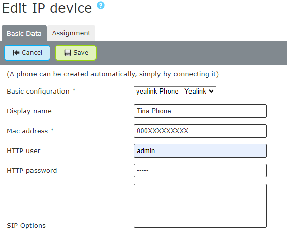

Log into your PASCOM cloud phone system and under **Devices** > **Device list** and press **Add** and select the option **IP Telephone: Manufacturer Yealink**.
![Add new Yealink Phone](https://2713225-files.gitbook.io/~/files/v0/b/gitbook-x-prod.appspot.com/o/spaces%2FVIw0BpSv358R2Pr2HflD%2Fuploads%2Fgit-blob-b520af94f4c119bb1ad4bd8a2bb68b5306a75ac8%2Fadd.en.png?alt=media)
Select a **display name** for the telephone.
Under the corresponding field, enter the **Mac-Address** that you have just found and noted.
To be on the safe side, use your own **HTTP user** and **HTTP password** data for the phone. This will overwrite the manufacturer's default data during provisioning.

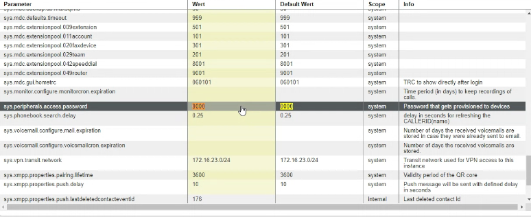

If you want to provision many endpoints, you can set a separate **HTTP password** globally for all provisioning in the system settings.

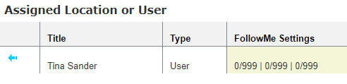

### 3. Assigning Users
As soon as the IP phone has appeared in the Device List, it can be edited via the **Edit** button. Under the **Assign** tab, the phone can be assigned to a [user (or location)](/en/setup/user/user-concept.md)
