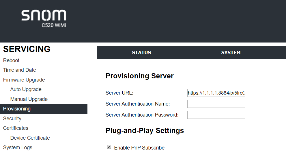

## Provisioning the Conference System
Check the conference system in the device list and go to **Action**> **Provisioning URL** where you can copy the **provisioning URL** to the clipboard.
With the IP address noted at the beginning, go to the web interface of your SNOM conference system. Under **Servicing**> **Provisioning** you will find the **Server URL** field in which the **Provisioning URL** must be stored. Click on **Save** and restart the conference system by clicking on **Reboot**.
