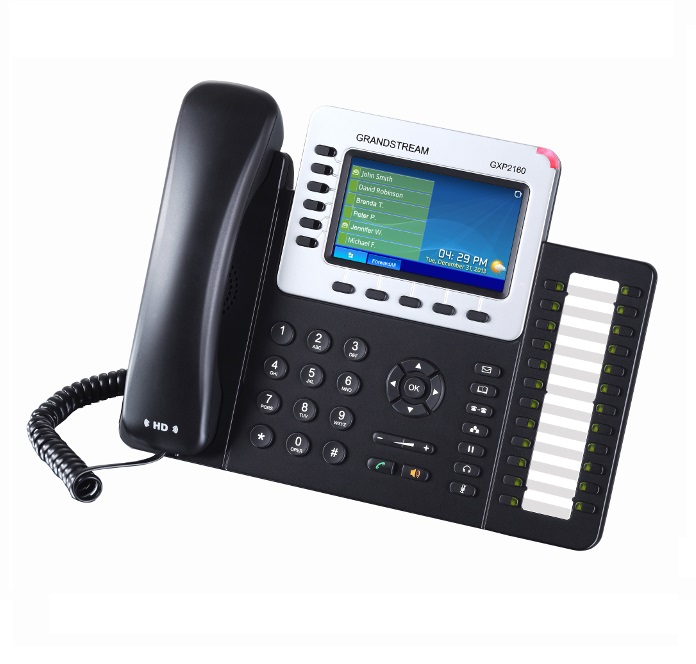

<figure><img src="https://2713225-files.gitbook.io/~/files/v0/b/gitbook-x-prod.appspot.com/o/spaces%2FVIw0BpSv358R2Pr2HflD%2Fuploads%2Fgit-blob-3398d74a79368f12f949981dc48840b3ccebbf17%2Fgrandstream_GXP2160.jpg?alt=media" alt="Grandstream GXP2160" width="400"><figcaption></figcaption></figure>
