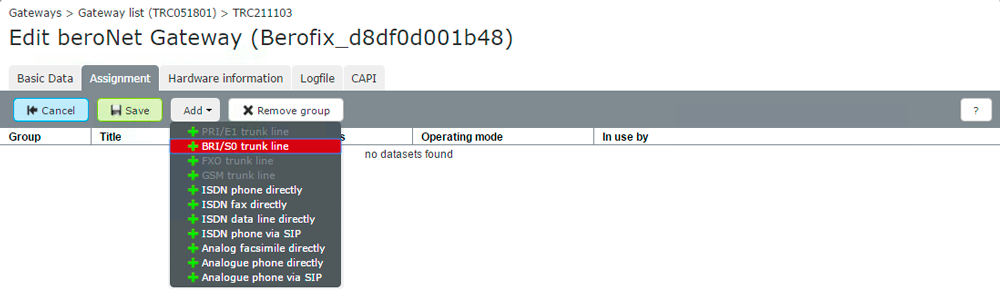

A common use case for beroNet hardware is to connect ISDN trunks to it. To do so, select the gateway you want to use from the list, click the **Edit** button and then switch to the **Allocation** tab.
<figure><img src="https://2713225-files.gitbook.io/~/files/v0/b/gitbook-x-prod.appspot.com/o/spaces%2FVIw0BpSv358R2Pr2HflD%2Fuploads%2Fgit-blob-e53a5d4ca317709f266b62c34c7304c9e450c49d%2Fisdn_trunk_add.en.png?alt=media" alt="Screenshot - Add ISDN Trunk" width="90%"><figcaption></figcaption></figure>
Click **Add** to configure either a **BRI** or **PRI Trunk line** .

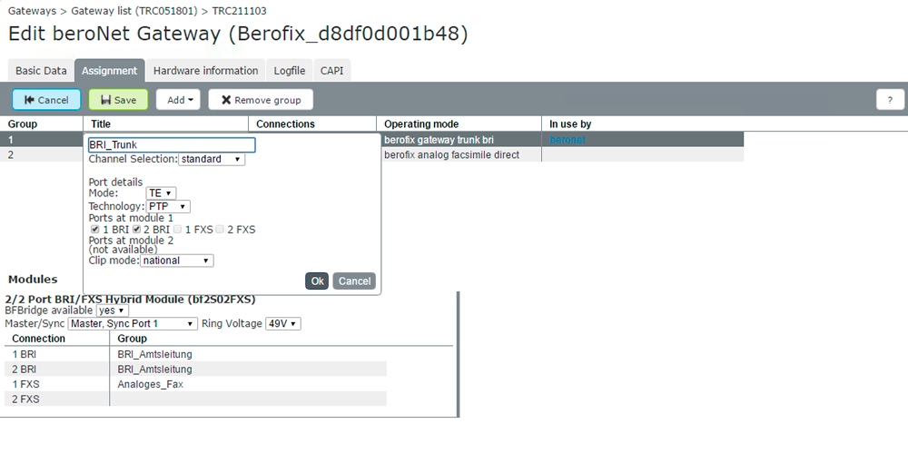

<figure><img src="https://2713225-files.gitbook.io/~/files/v0/b/gitbook-x-prod.appspot.com/o/spaces%2FVIw0BpSv358R2Pr2HflD%2Fuploads%2Fgit-blob-b08fccacfba3b00a63ff0603dbbc3e84f877b66c%2Fisdn_trunk_add_detail.en.png?alt=media" alt="Screenshot - Add ISDN Trunk in Detail" width="90%"><figcaption></figcaption></figure>
Double-clicking on the field **Name**. This will open a more detailed view in which you can select which **Ports** are allocated to the trunk. It is possible to select multiple options here, for example, for a BRI connection multiple NTs are aggregated so they form a single trunk.
Under **Mode** and **Technology** configure the interface type. For BRI connections, the interface should be set to **TE** and **PTP**.
You have now configured the interface of the beroNet hardware. For complete functionality, you should now continue with the appropriate Trunks and Call Rules configuration under **Gateways** > **Trunks** > **Add**. To help you, use the **Trunk Template** **beroNet Gateway**.

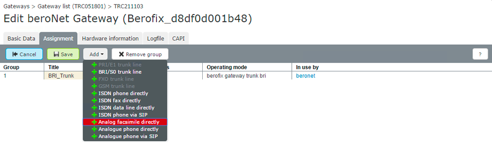

Select the desired Gateway from the list and press **Edit** and switch to the **Allocation** tab.
<figure><img src="https://2713225-files.gitbook.io/~/files/v0/b/gitbook-x-prod.appspot.com/o/spaces%2FVIw0BpSv358R2Pr2HflD%2Fuploads%2Fgit-blob-cc3f4c10cd194d329b38f9dd983f5103aa28ab16%2Fanalog_add.en.png?alt=media" alt="Screenshot - Add Analog Endpoint" width="90%"><figcaption></figcaption></figure>
The **Add** dropdown includes the following options:
| Type                       | Description                                                           | Uses                                                 |
| Analogue terminal directly | Analogue terminal device being routed directly on beroNet hardware    | Fax, door control, fire alarm system                 |
| Analogue terminal via SIP  | Analogue terminal device being routed on the PBX                      | Telephones                                           |
| ISDN telephone directly    | ISDN telephone being routed directly on beroNet hardware              | Emergency phone                                      |
| ISDN fax directly          | ISDN fax being routed directly on beroNet hardware                    | Fax server (e.g. Tobit Faxware)                      |
| ISDN data directly         | ISDN data transmission line being routed directly on beroNet hardware | Online banking, ISDN machine control, Security alarm |
| ISDN telephone via SIP     | ISDN telephone being routed on the PBX                                | Telephones                                           |
You have now configured the connection of the beroNet hardware. For complete functionality, you should now continue with Endpoint deployment under **Devices** > **Device List** > **Add** and select the appropriate endpoint type listed under **Via beroNet Gateway** from the list.
