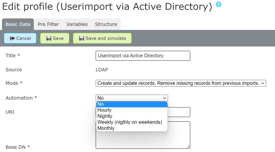

In the **Basedata** tab of the connector, you can have the PASCOM telephone system perform the data import automatically at certain intervals.
<figure><img src="https://2713225-files.gitbook.io/~/files/v0/b/gitbook-x-prod.appspot.com/o/spaces%2FVIw0BpSv358R2Pr2HflD%2Fuploads%2Fgit-blob-aa3fcb40558fc1ce556542e7d929dee8837dace6%2Fautomation.en.jpg?alt=media" alt="automate connector" width="80%"><figcaption></figcaption></figure>
{% hint style="info" %}
Automation is only possible if the data does not come from a manual source (e.g. a CSV file), as it must be uploaded manually.
{% endhint %}
### Automation intervals explained.
With automation, you have no direct influence on fixed times at which the data import is to be performed. Instead, times are determined flexibly by the PASCOM telephone system. However, you can define the intervals at which the data import should be started.
**No**
* Automation is deactivated
**Hourly**
* Minute = 0 - 59
**Nightly**
* Minute = 0 - 59
* Hour = 22 - 05
**Weekly**
* Minute = 0 - 59
* Hour = 22 - 05
* Weekday = Saturday or Sunday
**Monthly**
* Minute = 0 - 59
* Hour = 22 - 05
* Day = Between 1st and 5th of the current month
### Automation examples
You want to perform a daily data import. To do this, select **Nightly**.
**Nightly**
* Minute = 0 - 59
* Hour = 22 - 05
The data import is then performed at a daily interval between 22:00 in the evening and 05:00 in the morning.
You want to perform a weekly data import. To do this, select **Weekly**.
**Weekly**
* Minute = 0 - 59
* Hour = 22 - 05
The data import is then performed at a weekly interval every Saturday or Sunday, between 22:00 in the evening and 05:00 in the morning.
